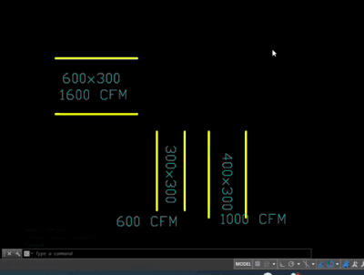

in this code, if the routine is canceling or stopped due to invalid values, the Object snap is getting 0. any solution to set back the osnap to user_osmode in all situations?

Please find attached
gif( for working)
complete lisp file
and sample dwg

I have a final question. For example, if you select all 5 lines correctly, and the 6th line made a selection of 1st line (by mistake)(as per the attached gif the second time command run) still you are getting back to user_osmode?

@smallƑish wrote:
... For example, if you select all 5 lines correctly, and the 6th line made a selection of 1st line (by mistake)(as per the attached gif the second time command run) still you are getting back to user_osmode?
In that case you need to add *error* function that will restore it.
Here is some example... note that *error* IS and NEEDS to be localized. Just the purple line is essential, the rest can always be the same.
Also note the structure...
