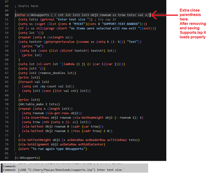

A "syntax error" often means a parentheses problem.  Could something have gone wrong in copying/pasting the code into a file, like not having selected all the way to the last right parenthesis?
When I pasted it into a file, in a Support File Search Path folder so I didn't need to spell out the path, it loaded for me.  [I haven't downloaded the drawing to try the command.]  Post the .lsp file as you saved it, so we can try loading it.

paullimapa
dnload attached revised supports.lsp

Thank you @paullimapa yes should only have had 2 right closing brackets. Updated above.

I think I know how double brackets occurred my fault. I sort the local variables and paste into code that is where extra bracket came from a last minute update.

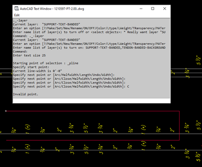

Good day Sea-Haven
Thank you for the updated Lisp. I tried it and it seems like it would work if it wasn't because when I go to select the area and create my boundaries, I will not let me choose "C" to close the selection area... what could possible be doing wrong? I tried in different drawings and I get the same result.

Sea-Haven
That is odd as I used "C" as last pick prompt. Or just press Enter, will have another look.
There may be a better way to select will try again.

israelU7LZU
I know it works for you, I just dont know what Im doing wrong. let me try pressing enter instead
