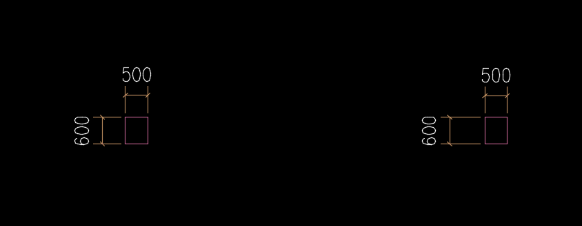

HI I NEED A LISP FOR DIMENSION FOR 2 FACES OF OBJECT (IF A RECTANGLE HAS 4 FACES BUT NEEDS 1 HORIZONTAL AND ANOTHER VERTICAL DIMENSION.) I HAVE MANY RECTANGULAR-SHAPED OBJECTS SO IT TAKES MORE TIME TO ADD DIMENSIONS.
FOR REFERENCE I ATTACHED AN IMAGE

Message 2 of 23
Kent1Cooper
Are they always and only orthogonally oriented as in your image?  Or might some of them sometimes be something like this?

Kent1Cooper
The more I think about it, the more questions I find....
For an orthogonal rectangle, do you want always the left and top edges dimensioned as in the image?  If at other angles, what should be the criteria for which two adjacent edges are dimensioned?
What should be the distance of the dimension lines from the rectangle edges?  That varies significantly in your image -- is there some reason for the differences?
Should it simply use whatever the current Dimension Style and Layer are, or should settings of those things be built in?
Meanwhile, there are routines out there that will do all edges, such as DimPoly.lsp, >here<, which defines a DPO command to do them on the Outside.  It might be easier to just adjust that to do only two edges, but that could depend on the answers to the questions.

CADaSchtroumpf
@archana96
With your drawing, you can try this:
(defun c:dim_pedestal ( / ss adoc space n ent dxf_ent l_pt p1 p2 p3)
  (setq ss (ssget "_X" '((0 . "LWPOLYLINE") (8 . "PEDESTAL"))))

Message 18 of 23
archana96
this one is good.
need small changes
1. With Lisp the dimensions come only from the layers that have pedestal layers. that does not look good please change that to any selected objects to provide dimensions.
2. the dimensions offset with this lisp  depends on the size of the rectangular/square (if the size of square/rectangular is 2000mm the dimension offset is 3000mm That is not good so give a minimum offset of 200mm (for refer I attached the image))PLAN.png
Message 19 of 23
CADaSchtroumpf
@archana96  a écrit :
this one is good.
need small changes
Change
the line 2 to :
  (setq ss (ssget '((0 . "LWPOLYLINE"))))
the line 26 to:
          (vlax-3d-point (polar p1 pi 300.0))
 and the line 32 to :
          (vlax-3d-point (polar p2 (* 0.5 pi) 300.0))
