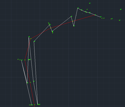

kajanthangavel
Hi @Sea-Haven , I changed your lisp.
I don't know, how to sort this polyline direction. If you can, give me a idea.

kajanthangavel
I need side by side.

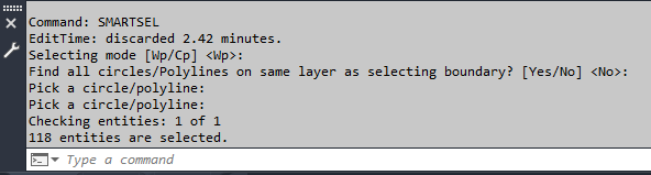

From the example file we can see the 'GE' actually is on both sides of the road.
Fortunately the road has a center polyline. If there is no road center line, please refer to my previous post and link all 'CL' into a road center line.
We can use this line to separate the GEs into 2 groups, one group for each side of the road.
For each group, use steps below to link GEs:
Step 1, Close the road center polyline and add a few more nodes to create a closed polyline enclosing all GEs on one side of the road.
Step 2, use SMARTSEL to select objects within the polyline.
Step 3, use QSELECT to exclude texts which content are not 'GE' from the selection.
Now all GEs on one side of the road are selected.
Step 4, use LINKPOINTS to link above GEs.
Step 5, repeat Step 2 to 4 to link GEs on the other side of the road. Result:

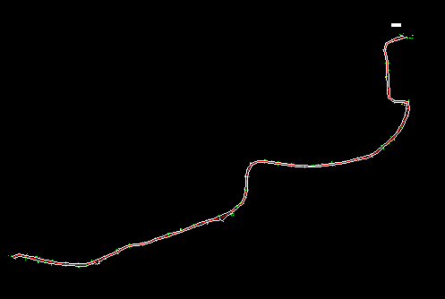

Message 10 of 15
kajanthangavel
Wow. 😘, Excellent work @Sea-Haven , You solved my problem, what I need.
Thank You so much. It is save lots of time.  😀😀

Sea-Haven
Having todo a lot of work around I have worked with field surveys for like 40 years the dwg provided is not a good survey, it needs string code or at least a, GEL GER or GE01 GE02 and so on. Our guys pick up like 10,000 points and would never do a multi gravel edges as GE.
Newer survey instruments have a cross section feature so will auto GE1 CL1 GE2 as 3 consecutive points.
I have been looking at doing a string points in this case would have ended up with a zig zag pline joining GE.
