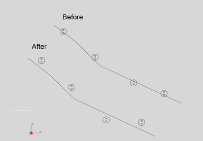

I am doing bulk imports of various types of data and more often than not it is intersecting lines that I do not want them too. I would like to have some script that could bump them in the direction they are overlapping. I attached a screenshot example of "before and after" of what I currently manually do
Any help or guidance would be greatly appreciated, it takes me hours to go through and manually fix these data points

Based on the sample drawing, this is how I would approach it:
(defun c:foo (/ bl d lw o p p2 s)
  ;; RJP » 2021-03-18
  (cond
    ((setq s (ssget "_X"
		    '((-4 . "<OR")
		      (0 . "LWPOLYLINE")
		      (-4 . "<AND")
		      (0 . "INSERT")
		      (2 . "IMPORT")
		      (-4 . "AND>")
		      (-4 . "OR>")
     (foreach e	(mapcar 'cadr (ssnamex s))
       (if (vlax-property-available-p (setq o (vlax-ename->vla-object e)) 'insertionpoint)
	 (setq bl (cons o bl))
	 (setq lw (cons o lw))
     (foreach b	bl
       (setq p (vlax-get b 'insertionpoint))
       (setq d (* 2. (vla-get-xscalefactor b)))
       (if
	 (vl-some
	   '(lambda (x)
	      (and (vlax-invoke b 'intersectwith x 0) (setq p2 (vlax-curve-getclosestpointto x p)))
	   lw
	  (vlax-invoke b 'move p (polar p (angle p2 p) (- d (distance p p2))))
  (princ)

@ronjonp wrote:
This is confusing to me. I wonder whether Before is really Before and After is really After. It somehow seems that at some moment is After Before while Before is really Before and then there is no After. In other moment is Before After while After is really After and now where is Before gone? Also, those moments comes back and forth... so they could be the other way around. Really confusing.
