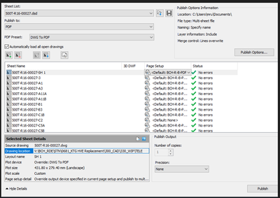

Hi there,
When AutoCAD files were changed location, for example,
from
C:\Users\mru\Documents\lisp
to
V:\BCH_RDE\STN\0785_CCB 48V Battery\300_CAD\330_WIP
The previous publish DSD file did not work. I find a lisp on the internet; it did not work.
The lisp from the internet is below
(load "dsd")
(dsd "C:\acad\job1\dwgset1.dsd" "c:\acad\job1\dwgset1-1.dsd")
Please see the screenshot below for AutoCAD publish interface,
Could you please help me to figure out this issue? thank you very much in advance. 🙂

mruPRQUJ
Hi there,
I need to manually change the path which is highlighted in the drawing location in the PUBLISH interface. Please see the screenshot below, it was attached as well, many thanks.
Message 7 of 17
LDShaw
If that's the case my first answer and Sea-Haven gave you the steps.
Does this clarify it?
Find the dsd file.
Open it in an editor.
Change the lines after [DWF6Sheet:
in my case.
DWG=\\Projects\2024\24FF01 - Ammonia System Upgrade\Cadd\24FF01_ax01-mech.dwg
So this
[DWF6Sheet:24FF01_ax01-mech-Layout1]
Layout=Layout1
Setup=DC 30x42 Bond
OriginalSheetPath=\\Projects\2024\24FF01 - Ammonia System Upgrade\Cadd\24FF01_ax01-mech.dwg
becomes
[DWF6Sheet:24FF01_ax01-mechtest-Layout1]
DWG=c:\dcapps\24FF01_ax01-mechtest.dwg
Layout=Layout1
Setup=DC 30x42 Bond
I've moved the dwg from a unc path on the network to my c drive in a folder called dcapps.
Post a SMALL dsd (no more than 3 dwg's in the dsd please) file and I will edit for you. Just tell me the path you want your dwg's to reside in. I will repost it so you can compare them.
