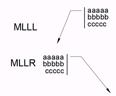

Hi everyone!
As for the Mleaders options using a text, it is possible to create a vertical line that follows the text as I indicated in the image on the right inside the green rectangle?
Thank you in advance for your help.

@andres_bonilla  Here is another version that adds string "|" in front or back to every line and squeezes text so that sideline don't look dashed. Ofcoures it can't be used on centered text for obvious reasons, but it will produce good result for most of situations.

Message 12 of 12
andres_bonilla
Thank you very much for your great contribution, the routine works very well, and it will be very helpful in developing the information within the plans.
