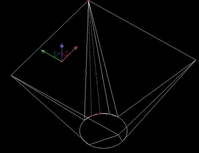

  • Currently I have a function in which the elevation (height or z coordinate) of polyline (square most of the time) and circle are compared and if they are in same elevation than gives error, and if not it runs a program called CONNVERTI.
  • In function CONNVERTI it ask user to select a circle and a polyline. After that it sets the number of segments circle will be divided into (which is 20).
  • A math calculation is set to start making points on circle with the increasing angle (from 0° to 360° so that it make points equal to number segments it has been set to).
  • After that connect two vertices of polyline to nearest quadrant (same with the other 3 quadrants connecting to nearest two vertices of polyline, and making a closed 3dpolyline surface will be make extrusion and it will not extrude if it's not a  made with closed surface with single line).  yashpn1805_0-1695065588018.png
  • The points which lies between two quadrants will be connect to the nearest vertex (same making closed surface single 3dpolyline).
  • Once all surfaces are created the than just extrude all surface with 1/4 inch thickness.
    The code I did is:

The code above is not working and giving error: bad argument type: VLA-OBJECT nil
Autocad file for reference:

There were a number of problems with your initial code. I modified it the best I could. You'll need to go back and adjust because with my modifications the 3dplines created look way too much (see attached dwg & lsp):

I got to a point where I need to create a 3polyline (3dpolyline because the two points will be on certain elevation, like on square/rectangle, and third one on other elevation, on circle) connecting three pre-defined points and the line should be connecting those point in continuous way as it will be extruded in future, so if it's a closed surface made by continuous 3d polyline than it will extrude otherwise it will not.
