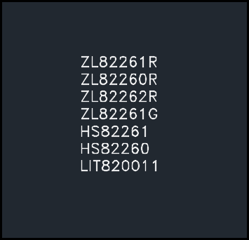

I was wondering if someone can create a find and replace lsp for us that does this steps. Thank you so much in advance once again.
Want to replace the spaces on the currently selected mtext to an enter command.
If I do and find and replace it will have to be something like this
Under "Find What" it will just be a single spacebar
Under "Replace  With" will be \u+000A. This is the code for replicating the enter function.
So once that hit "Relace "All" it should turn this currently selected mtext from this
To this

Try this [lightly tested]:
(defun C:S2EP (/ ss n obj); = Space(s) [to] Enter(s) with Pre-selection
  (if (setq ss (ssget "_I" '((0 . "MTEXT"))))
    (repeat (setq n (sslength ss))
      (setq obj (vlax-ename->vla-object (ssname ss (setq n (1- n)))))
      (vla-put-textstring obj (vl-string-translate " " "\n" (vla-get-textstring obj)))
    ); repeat
  ); if
  (princ)
); defun
[By the way, @john.uhden had the (vl-string-translate) arguments reversed.  But that function does all of them, eliminating @m_badran's (while) function needed if using (vl-string-subst).]

john.uhden
My apologies.
Apparently vl-string-translate can replace only an equal number of characters for another.
For example:
(vl-string-translate "123" "ABC" "lj;lABC  lkjlp329ABCs';lsdf")  will work, but
(vl-string-translate "A" "123" etc.)  will replace all "A"s with just "1"
John F. Uhden

burniksapwet
Thank you so much for the code. This is exactly what we are looking for. I appreciate the time and effort for this code. Thank you so much.
