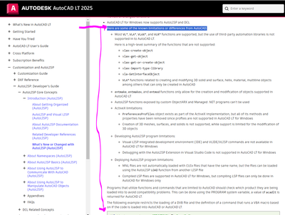

So I'm working in Civil but the lisp will be for AutoCAD LT.
Message 6 of 11
nicolasR6NGC
Thanks I didn't know these libraries are out there I much prefer to code in python than lisp.
Message 7 of 11
pendean
Community Legend
Community Legend
LISP in LT is limited: not all functions are available, you are more likely to hit a wall if the LISP author is a heavy VLAX coder
https://help.autodesk.com/view/ACDLT/2025/ENU/?guid=GUID-037BF4D4-755E-4A5C-8136-80E85CCEDF3E#:~:tex...
