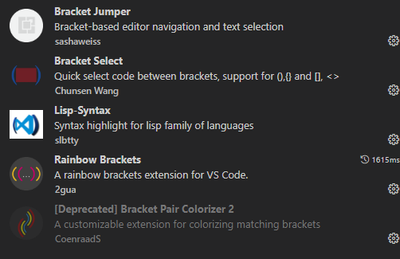

use a coder like the one recommended by Autodesk & install the matching bracket extensions to help you locate errors like this.

I just looked for things to catch my eye.  For a more formal approach, investigate the VLIDE command.  Others are better at it than I, but it's the diagnostic tool for this kind of thing.
