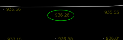

Kent1Cooper
The drawing does not answer the questions.  What constitutes "closest"?  There would need to be some kind of narrowing down of the possibilities.  I assume you would include this one:
But it's farther away than the ones at left and right -- by enough to disqualify it?  And this one, which is only barely farther from the path, but "feels" less likely to be wanted?
Is there a long-enough gap between the lower ones [that are obviously closer] that this one should be included?
Also, unfortunately, those are not Points, but tiny crosses made up of two Lines  [not quite zero-length -- 0.00002 units long], and in many cases four  Lines in two overlaid  crosses.  That would give you lots of duplicate identifications, whatever the criteria are.  A routine could theoretically consider all 2056 Lines in the drawing, and evaluate each one's distance from the path, and give you [one possible criterion] all of them that are less than 3 drawing units from it, in a list or a selection set.  But you'll get two or four items in such a list or selection set for every "point" location.  Would that be acceptable?  [You could reduce it to "only" two per location if you use OVERKILL on the drawing first.]
