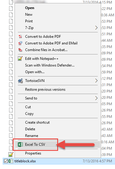

BlackBox_
You can always 'right click convert Excel to CSV' from File Explorer too... I do this for LISP apps where it's easier to manage the data using XLSx, but CSV is super easy for LISP to handle without the overhead required to work with Excel directly.
Circa 2016:  https://www.theswamp.org/index.php?topic=38330.msg567823#msg567823
"How we think determines what we do, and what we do determines what we get."
