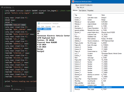

I have written this lisp to populate all fields on the title block using data from a text file.  The lisp is working, however every field is populated with the same piece of information.  I'm not sure where I have gone wrong and would appreciate any advice/direction that you all may have.
Here is the lisp:

It would help if you can include sample dwg with that title block and "GVOSStitleblk.txt"

There were a few problems which prevented the attribute values from updating:
1. Wrong Block Name:
(setq ss1 (ssget "X" '((2 . "Title Block GVOSS"))))
Change to this:
(setq ss1 (ssget "X" '((2 . "GVOSSTITLEBLOCK"))))  ; title block name
2. Matching Attribute Tag Name:
(= (dxf 2 el) (strcat tagname))
Since there's a mixture of upper vs lower everything should be converted to uppercase to get a match:
(= (strcase (dxf 2 el)) (strcase tagname))
3. If match occurred you decided to princ instead of updating the value:
(print tagname)
This either should be commented out or placed after the progn:
          (progn ; then do the following when there's a match
            (print tagname)
            (setq attstr (dxf 1 el)) ; no need to get current attribute value
            (setq el (subst (cons 1 newv) (assoc 1 el) el))
            (entmod el) ; Modify List
            (entupd bn) ; Update Screen
            (setq found "yes") ; Found Tag?
        (print tagname) ; this should be placed here if you want to see when no match
But after those are corrected now they update:

Lastly, I moved your subfunctions dxf & TAGFIND under GVTB & GVTB under C:GVTBIN the main command so they're not separate and then can be localized within the main function. FYI: I typically list the localized functions and variables alphabetically so I know I'm not repeating the use of them:
(defun C:GVTBIN
; localize functions and variables
 (/  GVTB unit )
(defun GVTB
; localize functions and variables alphabetically
  (UNIT
   desclgth dwglen dwgnm dwgnme dxf f homedir len_dwgnm len_unit
   newv startpnt TAGFIND ttlfil unit_stpnt UNITNM
(defun dxf (code elist)
  (cdr (assoc code elist))
) ; defun dxf
(defun TAGFIND (tagname newv / ss1 len count bn en el found attstr)
See attached updated code.

Thank you very much.   Works perfect.
