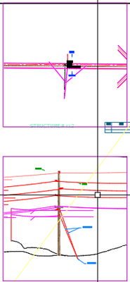

How would you go about rotating or (orbiting) a viewport to a 3D view. Even like just immitating clicking the home icon on the view cube but keeping the same object in the viewport.

Well, rotating the view is not exactly the hard part. The zoom level and keeping an object in view is more difficult.
Can you perhaps provide a sample drawing with 2 viewports in it? One viewport showing the beginning stage, and one showing the final stage?

Here is an example for you to look at.
So, the top viewport is what im starting with and am able to automatically populate for our drawings we are producing. However, I would like to take it just one step further and get it close to what it should look like. There will be minor tweaking from user at the end but that one step will help a lot.
The bottom view depicts a power pole structure which we have to show in a 3D view

If you look at the -viewport command you can set 3d view direction by simple x,y,z values, simple use 1,1,1 a 3d view, for front on etc replace a 1 with zero and you can use zoom C pt scale, this can be automated when creating viewports in a layout.
(if (= look "R")(command-s "-vpoint" "1,0,0"))
(if (= look "L")(command-s "-vpoint" "-1,0,0"))
(if (= look "F")(command-s "-vpoint" "0,-1,0"))
(if (= look "B")(command-s "-vpoint" "0,1,0"))
(if (= look "P")(command-s "-vpoint" "0,0,1"))
(if (= look "3")(command "_.vpoint" "1,1,1"))
(command "_.zoom" "all")
(setq zc (getpoint "\nPoint to centre of view in Viewport:"))
(command "zoom" "C" zc scl)

The sequence would be, make a view port, pick a point plan view say pole centre, then set vpoint 0,-1,0, then zoom c scale. note if you have poles behind they will appear as well, so you probably want a view direction option in the pan view a line behind pole with thickness on a non plottable layer will acts as a barrier to the see through effect.

So if you have multi viewports could be as simple as this as a start. You would just zoom in to a pole so can pick a base point, as mentioned will show those behind.
(defun c:zvw ( / scl pt)
(setq pt (getpoint "\nPick point"))
(command "vpoint" "0,-1,0")
(command "zoom" "c" pt 600)
