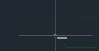

Please have look to the GIF illustration for easy understanding.
On the mline ( always single segmented) 2 mlines intersection on 45Dgr. while selecting the both mline. need a lisp automation to insert the "ELB_45"  Block referring mline orientation. Mline Style Name is "DR"
Cad file attached

_Tharwat
Here you go.

@smallƑish  hi,
check ELB45 command.
Note:
Previously your elbow90 and elbowT where suitable to mline width 20, in elbow45 width is 50 - how are you handling it?
enjoy

Message 5 of 39
smallƑish
Thank you so much—just like before, you made this so much easier, and it works perfectly for multiple pairs.
Regarding pipe size ,At first, I had some difficulty when working with different pipe sizes. But later, I adjusted the block size to 1mm and created a global variable (which we can set as pipe size) to multiply with the block insertion scale factor . This way, it works for any pipe size no limitations. Your code is really well-structured, which made it easy for someone like me to modify and adapt. Now we cant live with out those codes anymore. its important as oxygen to work  ❤️❤️❤️❤️

Moshe-A
I understand there are some mlines width (20, 50 and maybe others) so why not reading the width from the selected mline? this enable you to use the command without the need to change the code manually.
And i am thinking even going further by combining between elb90 and elb45 where the block name would be determines according to the angle between pairs of mlines.
Moshe

Moshe-A
@smallƑish  hi,
Attached new elbow.lsp that combines elb45 + elb90 + l2m all to one elbow command.
if you select lines (or plines) you will be prompt to specify mline scale.
i modify the blocks, actually reduce them to 1 drawing unit (1x1) such as when them are insert they scale by mline width which
is automatically read from the selected mlines (start using these modified blocks)
about elbowT is a different story and in the coming days i would try to combine it also
did not have the time to look what you post, maybe after this it is less relevant?
enjoy
Moshe
