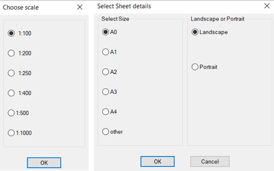

Did you google ? Have a look at maratovich solution.
Something I have. Small fee as it needs to be end user customised for title blocks.
