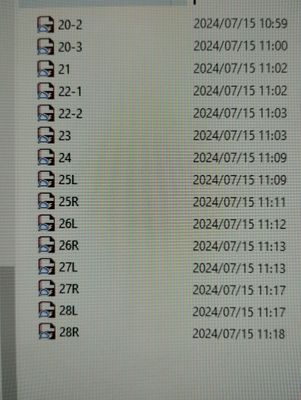

Can you post here a snapshot of the dxf folder? for the meantime i will add a check where the program stops so you it will spit out a message for the error.

clerigoaaron
@pbejse here

And does it show the same name in column A of your excel file?
Message 24 of 28
clerigoaaron
@pbejse sorry it was my bad i did not notice that the excel file started at column B. The code worked but for some reason some pipes from other project appeard also the text are so far away even though the code sets it as -30 and -45. Also pipe no. 24 is not appearing
