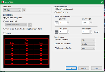

Thanks for that. I saved the code as 'Create_table_style.lsp', loaded it and I get this message.
Fails on line with: (setq custObj (vla-AddObject dictObj key class))
Command: (LOAD "C:/Disk8/create_table_style.lsp")
Error: Automation Error. AcRxClassName entry is not in the system registry
Error: Break...
I know that's an issue with my local PC, running ACAD license from work PC. I cannot get to the
Windows registry on that machine, so cannot test further. I see in the code, you can adjust text sizes
and 'style', but nothing to control Column Width (see OP sample.dwg)
OP (could just scale down that default table).
ECCAD
Message 6 of 10
paullimapa
@Sea-Haven I get that error too:
Though I do see the Table Style created but just not sure if it's complete:
I've used this function and modified it for me to create a Table Style:

Message 7 of 10
paullimapa
Found the error. Your code assumes a Text Style named "Arial" is already created in the drawing:
;; Set the text height and style for the Title row
 (vla-SetTextStyle custObj (+ acDataRow acHeaderRow acTitleRow) "Arial")
If you don't want to check and create a Text Style named "Arial" then you can just go with the default Text Style of Standard then it won't end with the error message:
 (vla-SetTextStyle custObj (+ acDataRow acHeaderRow acTitleRow) "Standard")

@ec-cad I understand when using vla-addtable it asks for columnwidth I was looking for a way to set the default value in the actual table style definition. But thinking more about it more , setting rows and column width allows for more rows & columns but still using the style say for height in particular.
 (createstyle "10texttable" 10.0 3  '(30 100 30)) will look into this more.
