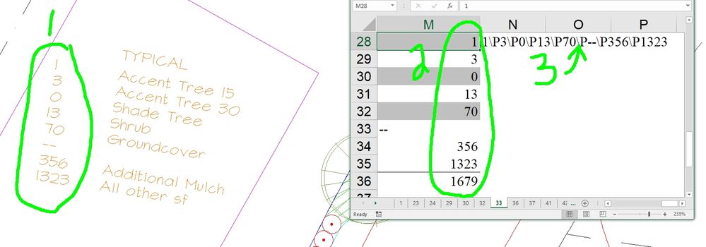

Can anyone direct me to a lisp that will copy all the text inside an mtext entity by clicking on the entity, so that I can paste it into excel?  I grow tired of double clicking the text, ctrl A, ctrl C, then ctrl V into Excel.  Just want to cut down the number of keystrokes for something I have to do a lot.  Thanks!

When I issue the command and click the area in circle one, it should paste into circle 2 as shown, but instead, I'm getting what's in circle 3.Clipboard01.jpg

Well, my code was basically the same as BeekeeCZ's, but I made a small modification to replace the \P with the right line break characters.
Try this.

mpa-la
Yours still put /p and pasted to one line instead of each text item going into a separate cell.
Message 10 of 42
mpa-la
Yours also put /p and pasted to one line instead of each text item going into a separate cell.
Message 11 of 42

DannyNL, I apologize, yours did work right!! Sorry, I had too many samples on my desk and I loaded the wrong one.  Winner winner chicken dinner!!  🙂
