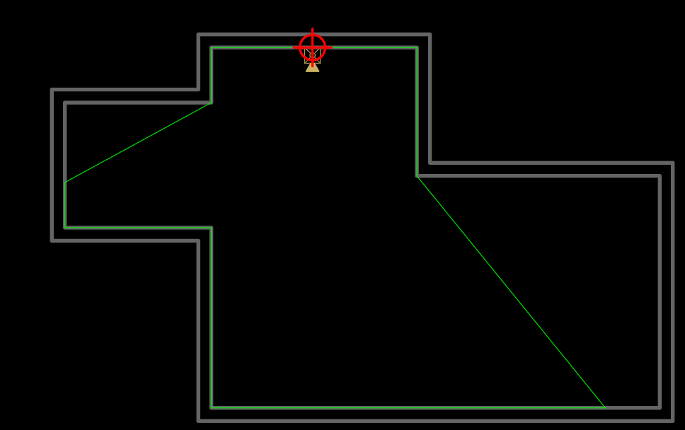

I am trying to come up with a way to visualize the strobe coverage for a fire alarm strobe.  What I would like to be able to do is select a point in the drawing from which a boundary will be generated based on the line of site from that location.  In other words, if I had a light on the wall, I want to show the boundary of where shadows will appear.  I created an example in the attached image by creating a line from the base point (red) to the nearest corners that break line of sight.  I then extended the lines to create the desired polygon.  I hope that all makes sense!  I would be happy with just this simplified visualization for now, but at some point it would be cool to include a specified range so that the boundaries do not exceed a certain distance from the selected point.

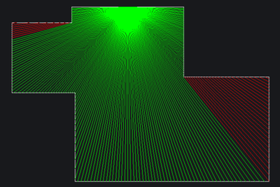

The recent post by @john.uhden inspired a different, and much simpler to implement, approach. Why not just cast a set of radial rays and see what "walls" they hit. Connect the intersection points and you have the shape of the strobe coverage.   The program sends out a ray every 1°. There are a couple of shortcomings to this approach including an excessive number of vertices and room corners may not be sharp.  A routine to delete excessive collinear points could address the first problem.
Here's a example solution. The red lines defines the shape of the room, the point is the location of the light and the green polyline the strobe coverage.
