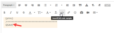

Message 4 of 11
ronjonp
So all those other routines load fine?
This is a bit odd:
BTW .. here is where the code tags are located. It makes the post more legible.

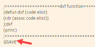

Message 6 of 11
raceharder
I do understand the purpose of the qsave.  I'm just not sure why the dxf function section is there.  I don't find the qsave odd as we want to save the file after updating the titleblock.  Is there a better way to do that or I guess can you clarify why you find that odd?  Not that I am questioning you, I am just trying to learn and understand.  I do appreciate your help.
RH

Message 11 of 11
Kent1Cooper
@raceharder wrote:
I do understand the purpose of the qsave.  ....
But not, apparently, the proper usage of it in an AutoLisp routine.  What's "odd" about it is the use of the raw command name, which would be appropriate in a SCRIPT or a command macro.  In an AutoLisp routine, it should be:
