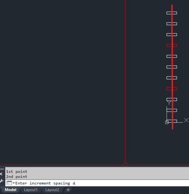

Dear Friends
I need help from anyone supporting me to select some items  from column or row every constant distance like a picture attached

Here you are dwg example as your request

What I'm trying to do is separate some of the emergency lights, each a certain number of headlights. It could be after two, three, or four scouts, and so on...all I need is a lisp. I can modify it to determine the number left.
you will find a new attach dwg example.
frankly, I do not understand the coding you write, may it useful but how I can use it ??

Thank you @Sea-Haven  very much for your help and your advice, Just I have one remaining for you is to explain how's your LSP work. because I tried to do it but there's nothing happen .
What I did ..select the first light from down and the first one from up as you write 1st and 2nd into your LSP and the number in increment space.
