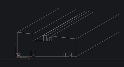

Can someone help me modify a LISP command? I used ChatGPT to create it, and it works just fine. The LISP is intended to, in a way, "extrude" linework in 2D to facilitate creating isometric drawings in AutoCAD LT. Now, I want to add code so that the "extruded" linework stops right when it intersects another line or geometry. For example, if I have a triangle with vertex A at the top, vertex B at bottom right, and vertex C at bottom left, and if I tell the lisp to extrude at 30 degrees due northeast at X length, I want the new line being extruded from vertex C to stop at the intersection with the existing line AB. I've tried telling ChatGPT to add code but it simply spits out some buggy code that never seems to work, even starting from scratch. I've attached the LISP code.

ChatGPT is doign better, but still a litlle talkative to isolate a pollyline list of points 😎
Make a little drawing if you please.
Is your goal (finding intersections if i understand) depending of the point of view ?

Thanks man, I really appreciate it! Some lines go past the first intersection and it seems to add double overlapping lines for the new extrusions, but I don't mind doing some touch up.

Can you post the drawing that has that issue. Thought I had them all resolved.
At some intersections, there will be (2) lines extruded, because they share a common
Vector point, end of line, beginning of next line at same point.. or vertex points of a Polyline,
that continues past that Vertex.
Maybe I can resolve that issue.
ECCAD
Message 10 of 21
jr_olmos23
I attached it. I put purple circles where the lines go past the 1st intersection.

OK, here's the scoop. The reason for lines that cross a line, but terminate a little further on, is,
the selection set (order). The program gets all the lines, etc, steps through them one at a time.
Could be upper left to lower right, or lower right to upper left, doesn't matter. Same thing will happen.
The main loop goes one element at a time, gets the start / end points, then calculates a ray (line) that
would be drawn say toward N.E., at the given length. Then, it passes the entire selection set to the
check_intersection function, along with the points of the (ray). The check routine then goes through all
the selection set items, gets there location points, and sees if the ray will intersect. IF it does, it then
returns the intersection point to the main program, which draws a line between the start point and the
adjusted endpoint. Since the intersection may be on a line that is (past) the line that it crosses, it draws
the line to that further line, terminating at the intersection. IF the main program then finds the line
that is 'closer' to the original point, it's too late, since the main program goes on to the 'next' point.
I don't know how to fix that. ??
I  tried a counter, to see if I could pick up the second intersection, no joy, since the main keeps chugging
along, and goes on to the next set of points.

Well, I got it to work for those remaining lines. Had to rework the check_intersection.. function (again).
Now looks for up to (4) intersections. IF more than 1, gets 'nearest' to begin point. Seems to work fine for
Lines, haven't tested for Arc's / Polylines.

Thanks, but I'm not familiar with 'wipeout' and didn't want to 'change' the original drawing as far as
converting lines to Plines. OP may not want to change, just add those new vectors.
I notice in your picture, there are (3) extra lines shown in the 2nd valLey area.
