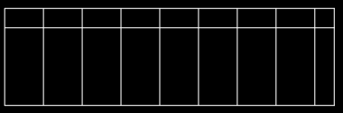

Interesting. The Autodesk directly expert was able to get the result I was getting. This is a picture of what I get after running that code, given my white rectangle is in the correct spot. As you can see, the last blue rectangle should be the same height as the others, but here it is 10' tall. If I move my white rectangle 5' to the left, then the second picture is my result. The last rectangle is placed at the correct 8' height. Nothing changed here besides the coordinates of my white rectangle.

It seems pretty obvious to me -- in test7.lsp, the remaining-on-the-right rectangle is defined by absolute coordinates, rather than in relation to what it's been doing.  Change this:
(command "RECTANGLE" (list 552.0 144.0) (list 576.0 240.0 ))
to something like this [untested]:
(command "RECTANGLE" (list currentX currentY) (list maxx (+ currentY rectHeight)))
[and of course with OSNAP not running].
ChatGPT is part of your problem -- it simply isn't good enough at AutoLisp yet.  It has led you astray in other ways, for example changing back to Layer 0 at the end doesn't do that [it should be the "_set" option, not the "_on" option].  And the "foam" Layer will be turned on by the "_make" option if it already exists but is off, so the "_on" option with that Layer is pointless, although "_thaw"ing it first could be advisable [it will have trouble if it exists but is frozen].

Running object snap modes including ENDpoint among them would perfectly explain the difference between the images in Message 10.  That has already been suggested as a cause -- have you tried with running Osnap off?  Or, force it to ignore that for that second point [or for both, but the first one will Snap to where you want it anyway]:
(command "RECTANGLE" (list 552.0 144.0) "_non" (list 576.0 240.0 ))
Kent Cooper, AIA
Message 18 of 27
tpottebaum
You're exactly right. I naively overlooked that suggestion initially. I never would have thought that would affect that command in my code. Turning off endpoint osnap solves all my problems.
