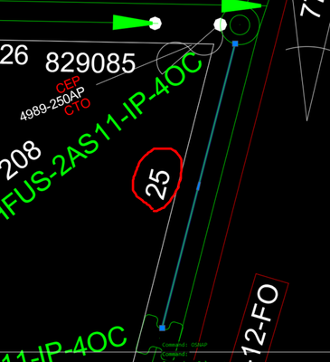

Hello, I'm trying to find some lisp that does the function of inserting the distance from one endpoint to the other, and inserting the distance an offset of 0.5 below the line, as in the example of the image.
She would have to do the whole line, because she has several endpoints.
If anyone has this lisp and can share it, I would be extremely grateful.

If by that you mean that you want to put length indicators on all segments of a Polyline, maybe you can use DimPoly.lsp with its DPI and DPO commands, >here<.  Define a Dimension Style with both extension lines and both dimension lines suppressed.  The distance of the text part from the Polyline can be changed [see Message 47 there].
If a Polyline is not closed, it will choose somehow what it considers the "inside" and "outside" sides of it, so if you try one of the commands and it puts them on the wrong side, Undo and use the other command.
But it won't do it on a Line object, if you have those.  In your image, the highlighted object is not a Line, but a Polyline [I can tell from the shape of the midpoint grip], so maybe this will work for you.
