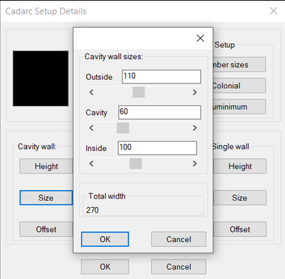

Thinking more about this if you put a value in a edit box you maybe can  call a child dcl that will appear over the current dcl, a dcl has an option "Paragraph" or just a simple child dcl with a label "Option A will be used". No answer at moment just an idea.
A child dcl Size is clicked.
Message 10 of 18
