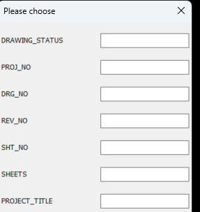

Make sure  "Multi getvals.lsp" is being loaded automatically use this as a test.
(if (not AH:getvalsm)(load "Multi Getvals.lsp"))
Then run the code above you should see your tagnames with blank values, fill in any value you want changed, leave blank if no change, see image above.

The tag name should be appearing in the dcl created then the value for that tag is blank and you can change. This code works with any block, possible disclaimer not checked with dynamic blocks.
Post your real dwg.
 This is just a random dwg downloaded from here, containing a block and I picked the block. You can see tag names. The values are blank change as required can do more than 1 tag name.
