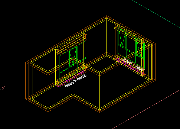

Like start with outside overall dims ?
Enter sizes as per images
Then loop through each window size adding a block with size atrributes in it.
I thought that there may only be a few styles like all equal width,  A & B windows, A & B & A thats 3 but would be 5 7 9 your sample has 5 with 2 widths what I would call A & B & A. Just makes it easier to automate the answer, the other option would be enter sizes.

Sea-Haven
The window image was from a house package it asks questions and just draws what the user enters its 2D/3D as it punches holes in walls.
I will try to do something for you fit it in other stuff over this week, idea behind ABA et was to reduce questions. Understand want dimmed as well 1st go will be draw outlines.
