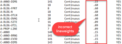

How can I get the lineweight to come out as it is set in inches? this current code is extracting it as something else. New to the lisp world so sorry if this is an obvious question.
Here is the code I am using
(lambda ( x / w )
(if (minusp (setq w (vla-get-lineweight x)))
"DEFAULT"
(rtos (/ w 100.) 2 2)
Thank you for your help!!

@Anonymous wrote:
(lambda ( x / w )
"DEFAULT"
(rtos (/ w 100.) 2 2) is the problem. It divides the returned linweight by 100 and displays it as a decimal with 2 decimal places
As a guess try (rtos w (getvar 'lunits) (getvar 'luprec)) or "lobby" to move to the metric system. 😉
