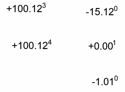

Hello Everyone!
I fixed an old levelling program which I found on the internet, but didn't work me.
Everything is working now, but I want to write the third decimal number in superscript (which is the mm height).
I tried the way that I defined different functions, and with RTOS I can get (RTOS yvalue 2 3) - (RTOS yvalue 2 2) = 0.00x
 (SETQ ltext1 (LM:RTOS yvalue 2 2))
;         (SETQ ltext2 (LM:RTOS yvalue 2 3))
;         (SETQ ltext3 (- ltext2 ltext1))
;         (SETQ ltext4 (* 1000 ltext3))
	 (SETQ ltext (STRCAT prefix ltext1 (something magical to have superscript) ltext4))
than I would have the "ltext" which I insert to an Mtext of a dynamic block.
Instead of this: image.png  I'd like to have this:  miklosbartal_0-1642584815803.png
Lets see if there is a solution, thank you for your help in advance!

Try this code. It creates MTEXT with third decimal in superscript. Since you say that you know some lisp programing you can modify this code according to your needs.
(defun ltrs(val / a b c d pt pref)
(if (< val 0.0) (setq pref "-")(setq pref "+"))
(setq val (atof(rtos (abs val) 2 3)))
(setq a (fix val) b (* 1000.0(- val a)) c (rtos b 2 3))
(if (< b 10) (setq c (strcat "00" c)))
(if (and(>= b 10)(< b 100)) (setq c (strcat "0" c)))
(setq a (itoa a) b (substr c 1 2) d (substr c 3 1))
(setq a (strcat pref a "." b))
(setq a (strcat "\\A1;" a "{\\H0.7x;\\S" d "^;}"))

@miklos.bartal  Have you tested the code I provided? Do you need any changes or functionality?

Thank you for your answer, til now I had no time, but tomorrow I will try.
miklos.bartal
Hello!
I just finished the code and tried it.
It works but have some issues. Sometimes it has a negative superscript, and it seems randomly.
Do you have any idea?
there should be the problem somewhere:
(SETQ yvalue (+ yd ldatum))
	  (COND
	    ((= yvalue 0) (SETQ prefix "%%P")) ;level prefix if zero
	    ((> yvalue 0) (SETQ prefix "+")) ;level prefix if plus
	    ((< yvalue 0) (SETQ prefix "")) ;level prefix if minus
	    ) ;end cond
         (SETQ ltext1 (ATOF(LM:RTOS yvalue 2 2)))
         (SETQ ltext2 (ATOF(LM:RTOS yvalue 2 3)))
         (SETQ ltext3 (* 1000 (- ltext2 ltext1)))
         (SETQ ltext1 (LM:RTOS ltext1 2 2))
         (SETQ ltext3 (LM:RTOS ltext3 2 0))
	 (SETQ ltext (STRCAT prefix ltext1))
         (SETQ ltext (STRCAT "\\A1;" ltext "{\\H0.7x;\\S" ltext3 "^;}"))
Thanks!
miklos.bartal
And it is cheating with the mm heights.
In my point of view the ltext2 is always bigger than ltext1, because rtos cuts the initial yvalue after the specified decimal place and do not rounding at all. So I don't understand what is the problem.

@miklos.bartal  Have you tried code I provided? It worked well for all test cases and I applied corrections in case when decimal part is either .00x or .0xx since using rtos on decimal part will omit zeros.  Currently have no time to test your code.
