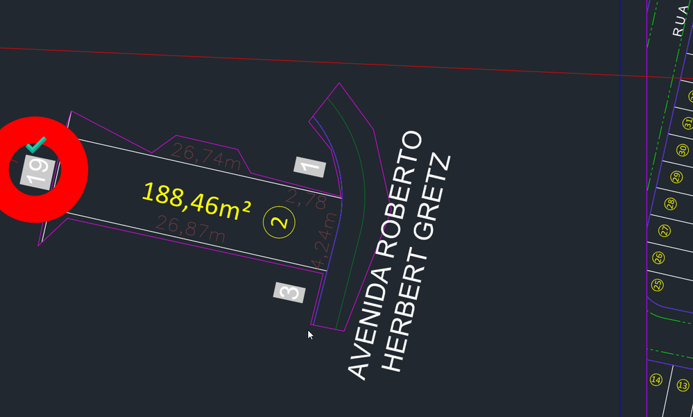

Message 13 of 16
F.Camargo
Can I get a field contents on layout "Lote nº 2" to a field formula on "Lote nº 3"?

BlackBox_
Add Field, select Formula, right click to insert FieldAdd Field, select Formula, right click to insert FieldThis Field should reference the Object contentsThis Field should reference the Object contentsThen increment up/downThen increment up/downEt voilàEt voilà

F.Camargo
How can I do to get 20 text field from a previously layout?
This is the result for the field to each layout tab

BlackBox_
Change your increment... instead of plus (+) or minus (-) 1, maybe you need 2 or 3... you control the result by modifying the formula.
