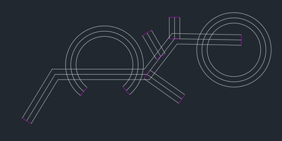

bit of a stretch but do you know of anyway to make this LSP or another LSP be able to close multiple pairs of lines at once?
attached a .dwg of what i mean, i want to cap off every open section so it becomes one entity/ closed poly line, it needs to be hatched after this so needs to be closed (easy enough to do with select and close if all the lines are there)

Apart from setting the current Layer to that of one of the Lines [what if they're on different Layers?] and not setting it back, I don't see any advantage to that over just having ENDpoint Osnap on [which I virtually always do anyway] and just using the plain old LINE command.  You're going to need to pick twice near the desired ends, so just Osnap to them.
It can also be thrown off by geometric relationships.  With the white being the existing Lines, and the dashed green being the drag-across line, this red result works as expected:
but in these kinds of situations it "sees" the wrong ends:
BUT it has the advantage over mine that it will at least do angled closures and connect ends of non-parallel Lines [if you need to do those] -- mine checks that the ends are parallel and line up in such a way that in the Line-closure option the result is perpendicular, because of its other closure options that don't make sense otherwise.

That would be challenging.  I assume you would want to select all of that stuff in a big window or something.  So a routine would need to figure out which open ends are close to which other open ends -- probably by storing all ends of all non-closed Polylines [or Lines, if you might use those sometimes], eliminating any that have an end of another object at the same place, and doing distance comparisons.  It may be possible, but I can't work on that right now.

And would they always be lined-up-and-parallel at their ends [the kind of relationships that CapEnd.lsp accepts], or might you sometimes have situations like these to close [red being the closure Lines]?
Kent Cooper, AIA

For my use case the ends are going to be parallel, but I could see how having non parallel lines could be handy also.
Just an idea for how to work out which lines to join to which, could you do something like;
Join all lines already touching, I.e join command, then set them all to counter clockwise, delete coincident/colinear points (they occasionally pop up when I connect these objects)  then however the lisp actually works, analyse each point like how you do with the vertex skip button, get the coords for every first and last point of each line, save those to a list and then cap the ends that are closest (normal cap end function)
So;
line 1, vertex 1 will be parallel or nearest to line 4 vertex 7
Line 1, vertex 6 will be near line 8, vertex 2
