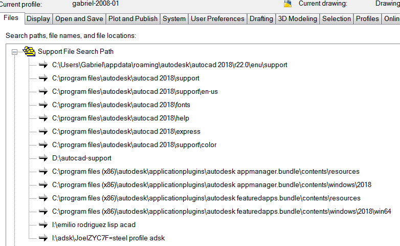

All,
I am in search of a LISP Routine that offers a dialogue for drawing various steel shapes. I have found a few different routines, but none of them are compatible with AutoCAD2017. I have the understanding that there are a few things that you can change in an older code to change the compatibility, to a newer CAD version. unfortunately I'm not savvy enough to modify the code to make it work.
I would prefer to have W, C, MC, Angle, and HSS shapes at my disposal. But I will take what I can get.
thanks,

1. The Lisps wont work after being loaded and run. after reaching out to a more experienced draftsman, they said the LISP could be too old to be compatible with my current version of CAD. He said that the routine can be updated to get it to work with the newer version. but I do not know how to do that.
2. see attached. I also used a lisp (I have deleted) that had been titled "Al's Steel Mill" or something along those lines. I know they were both developed in 2001 and 2007 versions of CAD

I test on 2018 plain ACAD and it work as need  ,  Of course I state by OPTION where the ACAD have to search for the DCL file.
Message 7 of 8

That's where I went wrong, I had forgot to set up my support file, thanks for the quick answer!
