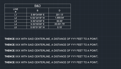

Hi, I have tried and tried again to get this to work, but I need to learn to walk before I learn to run with things like this. I have a table that has a header row, and a title row that I don't care about. It also has one column on the far left side "The Line # column" that I don't care about. What I am after is the Bearing (B) column and Distance (D) column. I would like to extract L1-B, and put its text in the first THENCE line in place of "XXX", and then extract L1-D, and put its text (MINUS THE FOOT SYMBOL " ' " in place of "YYY". I would like to do this for all rows no matter how long the table is (it is not always 5 lines).
The final product should look like this:
My approaches did not work, and I wasn't able to even really extract the data much less convert it into MTEXT format.
If anyone could help me out it would be greatly appreciated! Thanks!

Ok to have a go you need to GET a cell text.
(setq obj (vlax-ename->vla-object (car  (entsel "Pick table "))))
(setq cellvalue (vlax-variant-value (vla-GETCELLVALUE OBJ row col)))
Then use repeat to loop through the values start at row 1 as 0 is top row.
(setq cols (vlax-get-property obj 'columns))
(setq rows (vlax-get-property obj 'rows))
komondormrex
hey,
you'd better start learning to fly)
(defun make_rows (cell_raw_list / row_list)
  	(if cell_raw_list
		(setq row_list (cons
							   (list (car cell_raw_list) (cadr cell_raw_list) (caddr cell_raw_list) )
							   (make_rows (cdddr cell_raw_list))
  	row_list
(defun c:rip_table (/ table_ename columns_number skip_row row_list mtext_content)
	(setq table_ename (car (entsel "\nPick a table to rip: "))
		  columns_number (vla-get-columns (vlax-ename->vla-object table_ename))
		  skip_row 2
		  row_list (make_rows (mapcar 'cdr (vl-remove-if-not '(lambda (group) (= 302 (car group))) (entget table_ename))))
		  row_list (repeat skip_row (setq row_list (cdr row_list)))
		  mtext_content ""
	(vla-addmtext (vla-get-block (vla-get-activelayout (vla-get-activedocument (vlax-get-acad-object))))
				  (vlax-3d-point (trans (getpoint "\Pick upper left corner of mtext of ripped cells: ") 1 0))
				  0
				  (foreach row row_list
					(setq mtext_content (strcat mtext_content "THENCE "
												(cadr row)
												" SAID CENTERLINE, A DISTANCE OF "
												(substr (last row) 1 (1- (strlen (last row))))
												" FEET TO A POINT;\\P"
zac_bullock
Works like a charm. Thank so much! Exactly what I needed 😁
I'm trying to learn slow and steady because just trying to throw myself out of a plane without a parachute has confused me greatly! I'm reading Essential Autolisp now, taken a short course, and continuing to learn from the code that you and others help me with to form a deeper understanding of Autolisp. So thank you again!!!
