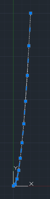

... to elaborate from my perspective, AutoCAD represents data in a visual manner. This means we need to have clear definitions of the items we create. So a formula that represents Infinite possible outcomes from Infinite possible inputs is not a viable definition to create defined geometry in AutoCAD.
Take the formula Y = X^2...
There are infinite possibilities for X and infinite results for Y. We cannot draw infinite verticies in AutoCAD.
But, when we add some limitations and clear parameters to our formula it becomes more suitable for drawing.
Ex: Y = X^2 (where Xmin = 0, Xmax = 10, and interval = 1)
The above limitations allow us to create a geometry line in Autocad to represent the formula:
...albeit the line is not a completely accurate representation with our interval, so some level of accuracy must be accepted so that we can clearly define our geometry to create.
If we lower our interval to a small decimal (such as 0.001) then we can more-clearly see our representation:
...but this is more strenuous on the geometry portion and file sizes. So a medium must be reached.
So overall, with limitations, formulas can be represented in AutoCAD with Very clear definitions, goals, and acceptable margins of error of our desired outcome.
Code used:

(defun c:FORMULA ( / Xmin Xmax Y interval pList)
(setq Xmin 0
      Xmax 10
      interval 0.001)
(setq X Xmin)
(while (<= X Xmax)
	(setq Y (expt X 2))
	(setq pList (cons (list X Y) pList))
	(setq X (+ X interval))
);while
(setq pList (reverse pList))
(LWPoly pList 0)
(princ)
);defun
(defun LWPoly (lst cls)
(entmakex (append (list (cons 0 "LWPOLYLINE")
                        (cons 100 "AcDbEntity")
                        (cons 100 "AcDbPolyline")
                        (cons 90 (length lst))
                        (cons 70 cls))
                  (mapcar (function (lambda (p) (cons 10 p))) lst))))
