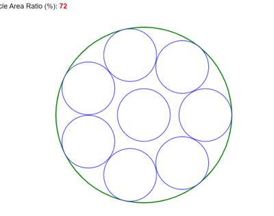

HELLO GUYS,
IS THERE ANY LISP THAT CAN PLACE EQUAL SIZE SMALL CIRCLES INSIDE A BIG CIRCLE?
LISP SHOULD ASK THE DIAMETER OF BOTH THE CIRCLES.
NOTE: THE SMALL CIRCLES SHOULD NOT BE OVERLAP EACH OTHER.
IT WOULD BE REALLY GREAT HELP.
MATHEMATICAL EQUATION IS
Formula:
n = (3.14* R^2) / ( 2 * r)^2     (corrected the formula and have taken reference from https://www.easycalculation.com/analytical/inner-circular-ring-calculator.php)
Where, r = Diameter of Inner Circle
R = Diameter of Outer Circle
n = Number of Circles in Inner Ring

Something's wrong with your formula.  In this image [pardon the crudeness -- sketched in the Snipping tool]:
the length of the red is your pi * R [assuming you meant R rather than R2]. and the green is your 2 * r.  Shouldn't the red be in at the centers of the ring of Circles, that is, pi * (R - r)?  Even then, it could think more smaller Circles will fit than actually will, at least in some cases, because of the difference between the curvature of the red and the straightness of the green.  And shouldn't the full circumference of a (R - r)-radius virtual Circle be used, so that it's possible to get an odd-number result?
Should your formula be written this way?
n = [(3.14 * R) / (2 * r)] * 2
If that's what you intended, I think it should be:
n = (2 * 3.14 * [R - r]) / (2 * r)
but that still needs some compensation for the green being a chord on the red:

Looking at your image, it's clear to me that to achieve what you've shown, simply
R=3r
I suspect it gets more complicated with the the more rings you add, but there's probably some formula.

Kent1Cooper
@Sea-Haven wrote:
Hmm Smaller Circles within a Larger Circle - Calculator (engineeringtoolbox.com) ....
There's something wrong with their formula, too, to the degree that it is capable of reporting a number different than it draws:
Kent Cooper, AIA

I figured out a calculation to get as many in a "tier" of smaller Circles as possible without them overlapping, including consideration of the chord across the virtual circle that goes through the centers of the smaller Circles.  Try this:

It made these.  The outer Circle radius is 10 in all cases; the smaller radius is the number beside each one:
There can be relationships between the two radii under which a strictly-tiered-polar-Array-ring approach would not yield the absolute maximum that could fit in, but being a little bit irregular toward the center can accommodate more.  For example, on the left is what the CinC command does with 10 and 2.3, but on the right, with a not-polar-Array adjustment in the middle, one more can be squeezed in:
But I don't know of a way to calculate for that possibility in the code.
