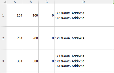

Hi. I'm looking for the same thing but in some cells I have a single line text and in some cells I have a multiline text. For example Screen Shot 04-02-19 002.PNG
Is there a way to insert multiline text? I'm trying to find it but I can't.
A long time ago I found somewhere you could copy a line from notepad to command line where you wrote
command, first corner, second corner, text
mtext 100,100 200,200 ......
but i forgot how to write the command for text. do you have to use quation marks or what. does anyone have an idea?

ivoitiuk
How to insert multiline text the same way as in example?
