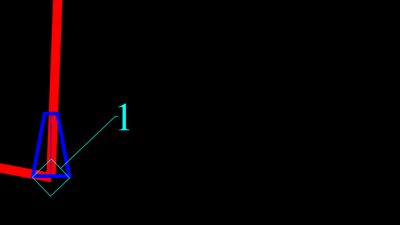

Please Help me to add leader like this but this number 1 from my excel Colum A.Amriya_Exe_1-1712429419407.png

This may not be exactly what you need, but try attached lisp. Reference dwg was produced with
a Block insert (instead of a Leader), but may be useful. See comments near end of lisp to put in
your blockname and path to it. I used the attached .csv for the sample. For your excel, make a copy, delete headers,
and all columns D and up. Save it in a MS-DOS format as a .csv file.
Hope this is close to what you need.
ECCAD
