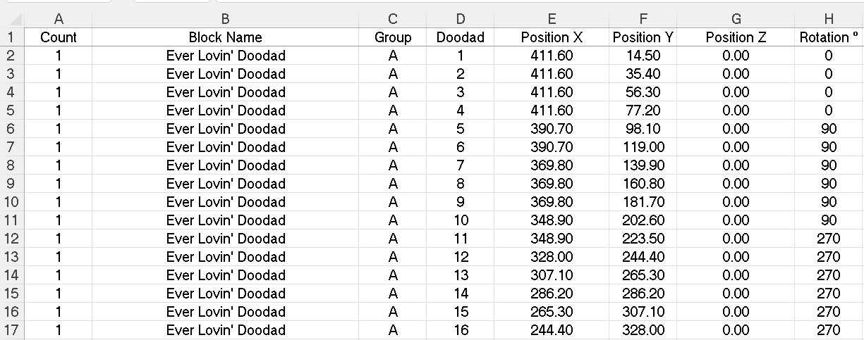

Hello all,
I have a need to provide positional data from a pattern of blocks that includes rotation.  Rotation still is not an option when using the AutoCAD data extraction tool.  I have not yet found a suitable solution after some time Googling and testing.  In the images below I have included an example of the data that I need.  I guess you could imagine that what I am trying to do is to produce a list to be used with a common set of components being installed by a pick & place machine with the source file being AutoCAD and not, say, Eagle.
I just spent some time manually adding rotation conditions to an Excel file for 306 components, and this is considered one of our small jobs.
Tom

Am I missing something?
tomascrocker
LOL!  You are missing nothing.  Just another example that one should read the entire menu before dismissing it.  Thanks, BeekeeCZ.
