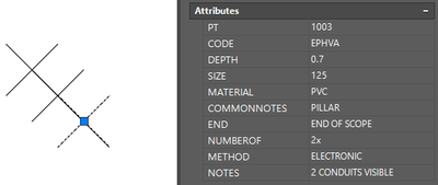

Hi all, quick recap of where I'm at:
I've got a full suite of LISP routines for several different automated annotation and calculation tools which worked beautifully until I moved employer. Previously I have been dealing with Trimble survey data exchanged as dxf's and the data in that format gave me "DIAG_CROSS" blocks with the point attributes written into the block. Having moved companies I now find myself dealing with Leica and LisCAD and the only reliable way I have of extracting point data with an extensive attribute from the survey kit set is via csv.
What I need is a LISP to read in a csv and create a "DIAG_CROSS" block at each of the coordinates and generate 8 block attributes that match the points attribute tables, the last column in the csv contains the target layer designation for the block.
Attached are a sample dxf in the format I used to deal with, and a csv (saved as a txt since I can't attach a csv) of invented points in the format I'll be using, the headers in the csv are what I need the block attributes to be called in the block, which I can then call on with the rest of my LISP suite. Across the whole set of survey points the number of attributes will always be the same and be called the same.
The format of the csv is:
PtNo.,x,y,z,CODE,DEPTH,SIZE,MATERIAL,COMMONNOTES,END,NUMBEROF,METHOD,NOTES,LAYER,
and the attributes I need to be named and attached to the blocks are:
PtNo.,CODE,DEPTH,SIZE,MATERIAL,COMMONNOTES,END,NUMBEROF,METHOD,NOTES. I don't need the elevation as displayed in the dwg.
I've set the last value as a fixed value in the survey controller for each code, so the LISP can call on it to set the layer for the block insertion.
Thanks in advance

what I'm going to do is reauthor a block called "diag_cross" at an appropriate scale. When the Trimble controller wrote out the survey data I had to rescale them because the size of the block when it arrived in CAD varied depending on the screen scale on the controller when the dxf file was written. So if I'm going to do that I should probably write a "DIAG_CROSS" with the attributes already in it?
I'm not interested in the colour of the block after it's inserted, they act as the 'anchor' when I use my Mleader LISPS and provide the autopopulate with the text strings I need to write the text body in the leader, and as long as I've given the block "By Block" colour assignation it will just adopt the LAYER colour in my drawing template, even if it doesn't the blocks are removed into a single layer called "Survey points" at the end of the drafting process by a FJ extended command I use. As long as the blocks end up in the correct layer the Mleader LISP will drop the leader into the correct layer based on "LAYER"_TXT and my template is already set up to assign colours etc to the text.
Thx

Message 8 of 34
hak_vz
In attachment are three files i.e. updated code, test file, and dwg with diag_cross attribute defined.
Default x and y scale for block are set to 0.1.

Gentlemen I couldn't thank you more for your contributions.
The LISP works perfectly 🙂
Apologies for you guys having to author the block on my behalf, by the time I realised you where trying to chase me up on it I was home with no CAD software, I only got the PM as I was faling into bed at midnight NZ time.
This has removed one of my biggest obstacles to my workflow for the immediate future TYVM

Message 13 of 34
orourkestuart
@ HAK_VZ, hey man I might have sent you wrong with my previous reply, when I run the LISP I think I missed the "too many arguments" prompt the first time and didn't realise. When I enter the attached file it inserts the first block but then stops and doesn't populate the block attributes, I get "too many arguments" in the command bar.
@pbejse, morning 🙂 Your script runs except I'm not getting the PT attribute populated. I've attached a .dwg that HAK_VZ was kind enough tom supply containing a diag_cross block in it that I will adopt as our own.

                 (cons 2 Nme)
                 (cons 70 0))))
(if (and
      (tblsearch "BLOCK" bname)
      (setq allData nil
	       csv (getfiled "Select data source" (getvar 'dwgprefix) "csv;txt" 16))
      (progn
  	(setq opf (open csv "r"))
	(setq NameAndTag (_DelTolst (read-line opf) 44))
	(setq listOfTags (mapcar 'strcase (cons (Car NameAndTag) (cddddr NameAndTag))))
	(while (setq data (read-line opf))
	(setq allData (cons (_DelTolst data 44) allData))
	(close opf)
	(setq sc (if (zerop (getvar 'Luprec)) 1.0 0.001))
	(foreach itm allData
	  (setq	pt
		 (mapcar 'atof (list (cadr itm) (caddr itm) (cadddr itm)))
	  (setq itm (cons (Car itm) (cddddr itm)))
	  (setq TagAndValue (mapcar 'cons listOfTags itm))
	  (setq	InsertedBlock
		 (vlax-invoke
		   spc 'InsertBlock pt bname sc sc sc 0)
	  (foreach att (Vlax-invoke InsertedBlock 'GetAttributes)
	    (if	(setq f (Assoc (strcase (vla-get-tagstring att)) TagAndValue)
	      (Vla-put-textstring att (Cdr f))
	  (if (not (tblsearch "Layer" (setq lname (last itm))))
	    	(Layer lname))
	  (Vla-put-layer InsertedBlock lname)
  (princ)
Now you can select either csv or txt
HTH
