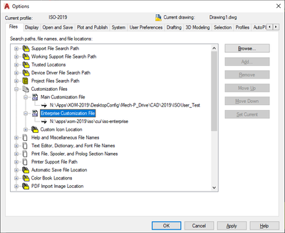

I am moving my CUIX to an Enterprise CUIX on our network so users do not change our standard menu.  When I load the company menu as my Main CUI with out an Enterprise CUI, it works fine.  When I change my options to to load an empty CUI as the Main and move my company menu to the Enterprise CUI, the tile menus are blank and there is garbage written in the header.
