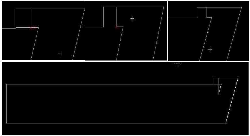

my new problem now is in the fillet command (same problem but different command)
now the x1, y1, x2, y2 are ok and creating mpt1 and mpt2 fine
but the fillet between mpt1 and mpt2 is not working... should be again a precision problem
_$ (setq x1(/ (+ xMin1 (car pts1234)) 2.00))
_$ (if (equal xMin1 (car pt1) 1e-4) (progn (setq y1(/ (+ (cadr pt1) (cadr pts1234)) 2.00)) ))
_$ (if (equal xMin1 (car pt2) 1e-4) (progn (setq y1(/ (+ (cadr pt2) (cadr pts1234)) 2.00)) ))
_$ (setq x2(/ (+ xMax2 (car pts1234)) 2.00))
_$ (if (equal xMax2 (car pt3) 1e-4) (progn (setq y2(/ (+ (cadr pt3) (cadr pts1234)) 2.00)) ))
_$ (if (equal xMax2 (car pt4) 1e-4) (progn (setq y2(/ (+ (cadr pt4) (cadr pts1234)) 2.00)) ))
_$ (setq mPt1(list x1 y1))
_$ (setq mPt2(list x2 y2))
_$ (command "._fillet" mPt1 mPt2)  ; sometimes works depending on the value that changes in every loop
_$ mpt1
(-157.329 229.418)
_$ mpt2
(-156.949 229.453)
nil
Is there a way to use fuzz factor on the FILLET command as well??

Message 7 of 25
stevor
Fuzz for fillet: not that I know.
You probably will use the more 'inters,
with the 5th argument, to get actual intersections,
instead of fillets, because the fillet can produce
different results for inputs that appear the same.
If you post an image of the desired result,
it would help.
S

Message 9 of 25
Kent1Cooper
nil
Without a sample drawing or image, I'm having a hard time imagining the exact situation.  It would help if you can provide one, with notes indicating the various locations of resulting variables.  From an illustration like that of what you are trying to do, it may be apparent that there's a different [read "easier"] way to do whatever it is.
Fillet doesn't require that kind of precision -- if the point variables are within pickbox range of appropriate objects, it should work [it does for me in quick experimentation, in Acad2017].  But are you sure there are always objects there?
This may not be the issue if you're getting mPt1 and mPt2 results, but....  Since you're not specifying nil as an 'onseg' argument to the (inters) function, your Lines must actually cross for it to return a point-location result.  If they ever don't cross [or at least meet], (inters) will return nil.
Kent Cooper, AIA
Message 10 of 25
Hi Kent,
Of course.
The problem is on the last fillet that is unstable like Stevor said.
I'm trying the fillet suggested by Stevor but it´s returning an error message
(command "._fillet" (osnap mPt1 "nea") (osnap mPt2 "nea"))
; error: Function cancelled
Thanks a lot

The code is creating the wrong drawing below, because the last FILLET lines are returning NIL in most of the times I execute it. That is the problem.
The code is created by a vbs macro routine inside a Qlikview application. There is no much more to say.  Please let me know if I forgot to give some info.
To reproduce the problem just open a new drawing in AUTOCAD and put the code inside a VLIDE editor (ENTER).
Thanks in advance,
Luis

So, I repeat the FILLET command
(if (= flag 1) (progn (command "._fillet" (osnap mPt12 "nea") (osnap mPt34 "nea") ) ))
And It does a fillet between a wrong line segments... but, does not returns NIL (it's some kind of progress I believe)
After that on the AUTOCAD I choose to undo the three last commands, that put the drawing back in the previous condition.
Finally I repeat the same FILLET command again
And it works fine but does not solve my problem, because I can't do that in my routine.
This problem is driving me crazy.
Any additional help will be appreciated.
Regards,
Luis
