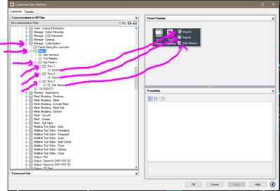

I have been trying to figure out how to have multiple lines of text on a button within a Custom ribbon panel (panel.png attachment. There are many AutoCAD native buttons that show this scenario (see customize panel.png attachment). Any knowledge on this would be appreciated.
I have also noticed that all buttons justify left, is there any way to change this behavior?
Thank you for your help.

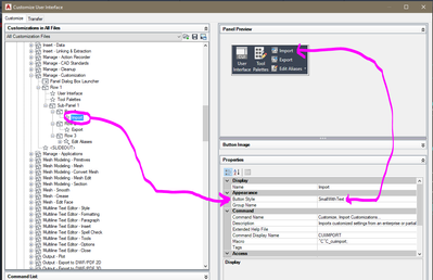

does it have something to do with the dropdown in CUI editor as shown in this pic
Message 3 of 8
jduframe
button style I have shown highlighted in blue on the right side
Message 4 of 8
KMeyer8AYA2
That dropdown just changes if/where it shows the text.
Message 5 of 8
jduframe
Oh OK, then I do not know, I am not familiar enough with this, hope someone has an answer for you

Is there a reason you are not able to go to the example you wish to emulate in CUI command to see how it is done? Or is it just that you don't quite understand the three stacked commands are in a sub-panel in three separate rows with icons set to text on the side and that is what you need to do to replicate for your items?
