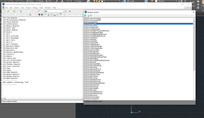

I want to test the properties , functions and the constants of Advance steeel Automations tlb
from the Advance steels objects now
I have not yet successful to register the  tlb or olb file for advance steel        (I tried to attach the latest tlb file we have got with Advance Steel such that you can test) but that denies attaching here
This is showing True here(Now i want to test the functions with asm-   , asc-
I used the command for Advance Steel tlb files
C:\Program Files\Autodesk\AutoCAD 2021\ADVS\AstorMain5.tlb
(vlax-import-type-library :tlb-filename "C:\\Program Files\\Autodesk\\AutoCAD 2021\\ADVS\\AstorMain5.tlb" :methods-prefix "asm-" :properties-prefix "asg-" :constants-prefix "asc-")
(Partial success to register vb6 olb here)
Thank you (i have registered the vb6 olb file but now want to access its methods in lisp)

dbroad
In AutoCAD, issue the vlide command.  In vlide, use the appropos window.  Search by prefix for vbm-.  It should give you a list of the methods that were imported. Likewise, the same for properties and constants.  You will need to get help from the advance steel application to correctly identify the number and type of arguments that each function requires.  Using the VBAIDE might help as the methods and properties would be the same.
BTW: In general, DLL files cannot be used as type libraries.
Again, I reiterate, use prefixes that relate to your application or to the type library itself.  VB is typically used to represent Visual Basic.  If you're trying to work with Advancesteel, I would suggest AVSM-, AVSP-, and AVSC- as logical prefixes.
Please note also that LISP is a single document language.  You will need to import the type library whenever you open a drawing that needs to use Advance Steel capabilities. (none of which I am familiar with).
Architect, Registered NC, VA, SC, & GA.

SanjoyNath
Thank you very much @dbroad
I will use these functions from the Advance Steel
For the Current situation it is the Accepted Solutions
For every time for every files we will use these at the starting
T
660  Objects found  for asm types that is advance steel methods
660 types of Advance Steel constants are found
760 asg types found

SanjoyNath
Dear @dbroad
Dear Experts,
Now I Tried to use
C:\Program Files (x86)\Common Files\Autodesk Shared\Advance\AdvanceExportsCOM16.exe
(vlax-import-type-library :tlb-filename "C:\\Program Files (x86)\\Common Files\\Autodesk Shared\\Advance\\AdvanceExportsCOM16.exe" :methods-prefix "ASGTCm-" :properties-prefix "ASGTCp-" :constants-prefix "ASGTCc-")
As per your suggestion to call exe files referencing directly
I tried
LOG Apropos results
ASGTCc-eConversionApp
ASGTCc-eConversionGTC
ASGTCm-ExportCIS2
ASGTCm-ExportIFC
ASGTCm-ExportPSS
ASGTCm-ExportSDNF
ASGTCm-GetAbortStatus
ASGTCm-HandleGTCSectionNotFound
ASGTCm-HandleImportFailed
ASGTCm-HandleMaterialNotFound
ASGTCm-HandleProfileNotFound
ASGTCm-ImportCIS2
ASGTCm-ImportIFC
ASGTCm-ImportPSS
ASGTCm-ImportSDNF
ASGTCm-SetApplication
ASGTCm-SetEventsHandler
ASGTCm-SetHostApplication
ASGTCp-get-Annotation
ASGTCp-get-AppIndex
ASGTCp-get-Application
ASGTCp-get-BeamOrientation
ASGTCp-get-BentBeamExportType
ASGTCp-get-Building
ASGTCp-get-CardinalPointAlwaysCenter
ASGTCp-get-Client
ASGTCp-get-CopeDrillDia
ASGTCp-get-CopeDrillType
ASGTCp-get-Drawer
ASGTCp-get-ExportCV2_0
ASGTCp-get-ExportHoles
ASGTCp-get-ExportSilentMode
ASGTCp-get-ExportType
ASGTCp-get-Features
ASGTCp-get-Lookup
ASGTCp-get-MajorVersion
ASGTCp-get-MinorVersion
ASGTCp-get-NotDefinedNumber
ASGTCp-get-OrderDate
ASGTCp-get-Precision
ASGTCp-get-ProfileDb
ASGTCp-get-Statics
ASGTCp-get-StrMajorVersion
ASGTCp-get-StrMinorVersion
ASGTCp-get-Version
ASGTCp-put-Annotation
ASGTCp-put-AppIndex
ASGTCp-put-Application
ASGTCp-put-BeamOrientation
ASGTCp-put-BentBeamExportType
ASGTCp-put-Building
ASGTCp-put-CardinalPointAlwaysCenter
ASGTCp-put-Client
ASGTCp-put-CopeDrillDia
ASGTCp-put-CopeDrillType
ASGTCp-put-Drawer
ASGTCp-put-ExportCV2_0
ASGTCp-put-ExportHoles
ASGTCp-put-ExportSilentMode
ASGTCp-put-ExportType
ASGTCp-put-Features
ASGTCp-put-Lookup
ASGTCp-put-MajorVersion
ASGTCp-put-MinorVersion
ASGTCp-put-NotDefinedNumber
ASGTCp-put-OrderDate
ASGTCp-put-Precision
ASGTCp-put-ProfileDb
ASGTCp-put-Statics
ASGTCp-put-StrMajorVersion
ASGTCp-put-StrMinorVersion
ASGTCp-put-Version
72 symbols containing "asgtc"
DID NOT WORK FOR AdvanceOdbcJetServer8x86.exe
(vlax-import-type-library :tlb-filename "C:\\Program Files (x86)\\Common Files\\Autodesk Shared\\Advance\\AdvanceOdbcJetServer8x86.exe" :methods-prefix "ASOm-" :properties-prefix "ASOp-" :constants-prefix "ASOc-")
Sanjoy Nath
BIM Manager And Digital Lead (Structures Online)
BOOST, AR , VR ,EPM,IFC API,PDF API , CAD API ,Revit API , Advance Steel API
Founder of Geometrifying Trigonometry(C)
Message 12 of 13
SanjoyNath
Dear Experts,
Thanks God
This is Microsoft scripts control
the dll from the  C:\Windows\SysWOW64\scrrun.dll           dll file loading says true
Which means now we can handle file reads writing like vb6 styles through Autolisp
(vlax-import-type-library :tlb-filename "C:\\Windows\\SysWOW64\\scrrun.dll" :methods-prefix "MSCm-" :properties-prefix "MSCp-" :constants-prefix "MSCc-")
With Apropos window we have seen that the 128 Scripting(Microsofts dll ) functions are loaded
LOG Apropos results
