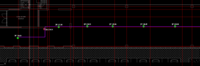

what can i use to arrange blocks that are cross by a polyline? I want to arrange only the blocks that i hvac selected according to the selected polyline.
Below I showed how i would like the arrangement to be

Is the Polyline always made of only line segments?  If so, its vertices can be extracted and used in a Fence selection in (ssget) to find things it crosses, and, very conveniently, their order in the selection set will be the order in which the Fence crosses them.  I think that will require that there is some drawn element in each Block where the Polyline crosses it, i.e. the Polyline doesn't pass through a gap in a Block, or something.
Kent Cooper, AIA
ronjonp
@adrianmihai1
Look at the function vlax-curve-getPointAtDist. This is assuming the start point of your line is on the left.
