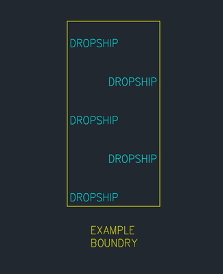

Can anyone help me with creating a custom .PAT file?  An example of what I am trying to do is in the attached drawing.  I have done some very simple ones in the past, but this one has me stumped.

Elaborate a bit more on it please: for example, are you needing this exact perfection in layout/display, and is that rectangle the only size?
And any reason why a BLOCK of all of that would not do well for you instead?
Message 3 of 12
Travis.Biddle
The rectangle is the default size of the object I will be hatching and shows the desired spacing between the text of the hatch.  The size may increase (never decrease) but the ratio between height and width always remains the same. Height of the rectangle will always be 2x of the width. I have other instances where a block of the pattern works, but will not for this case so I need hatching.

A Hatch pattern needs to be inherently repetitive.  If it's even possible [however extraordinarily complicated] to define a pattern involving all the bits making up the letters in those words, then if there's a "word" a certain distance up and to the right of, say, the one at lower left in your example, then there would be another one up and to the right of that by the same distance, etc.  Applying it in a boundary like yours would surely result in something like this:
So I don't think a Hatch pattern is what you want.
Is the idea that no matter the size of the boundary, the text pieces would be of the same size and spacing and displacement angle?  If the proportions of the boundary are always the same, and if the text size can change to go along with the boundary size, then a Block would work, but I assume that's not your situation.  Show some examples of what you're looking for at different boundary sizes.  If it's twice as big, do you still want 5 words?  Arranged similarly in relation to the boundary (e.g. same distances inboard, but spread out more -- another impossibility with a Hatch pattern)?  Etc.

I understand that it needs to be inherently repetitive so the example you show was expected and totally acceptable.

I was able to find a hatch generating lisp that was able to get it done.   Took me a little bit to get the desired result, but it worked.

Can you use SUPERHATCH?  These were done with it:
using a Block that looks like this:
without the dashed grey outline -- that's a 40-unit square used for spacing.  I used TXTEXP to get the incomplete words Trimmable to meet the square's edges.
But that depends, again, on whether you want the words the same size and spacing no matter what the boundary size.
