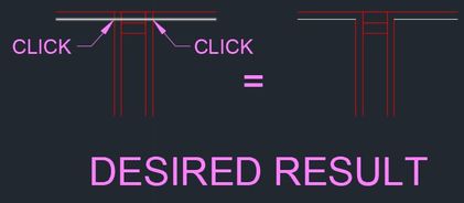

Hi all,
I have been working on this Break-Fillet lisp to use for doing building sections. I have utilized a program called FilletLines (by DannyNL, autodesk forums 01-23-2019 12:37 AM) to do the fillet portion.
See image for description of issues...
I have attached lisp.
Thank you in advance for any input received.
-dc

The point of the program is take a task that takes 7-8 clicks and do it in 2.

trim the white line, then fillet the red and while lines with 0 radius. With to clicks at the intersections.

They cross the white line.

I tried your code on my wall scenario, this is what I get:
This is what the original program does. It works well if only one wall on line to be "cleaned up"...
Two clicks: break (white line) and fillet wall finish lines (red) to ceiling finish line (white)
Works great.
The problem occurs if there is more than 1 wall along the line to be "Cleaned up"....
Should look look like this:
Not sure if this is something that can be remedied. As I said, it works perfect with one wall along ceiling line.
Message 12 of 25
DC-MWA
The walls are generated automatically as is the truss or ceiling framing above. The drafting is done by picking the bottom of the wall, then entering a height and the framing size from a menu. The wall is drawn with top plates and bottom plate as well as finish offset.

See image for explanation.
I have attached a drawing as well.
Please note, the program I uploaded works great as long as you only do one wall. Maybe a look at the original code may be easiest solution?

I disabled the fillet lines portion of original code. Looks like the break command is failing not the fillet.
I will continue to look.
Message 19 of 25
DC-MWA
Ok. On the 2nd and 3rd, 4th... passes, break is breaking the vertical lines instead of the horizontal lines.
Message 20 of 25
DC-MWA
This is crude, but I added:
(command ".draworder" "previous" "last" "" "f")
after the fillets are complete. It seems to work. I will continue to test.
