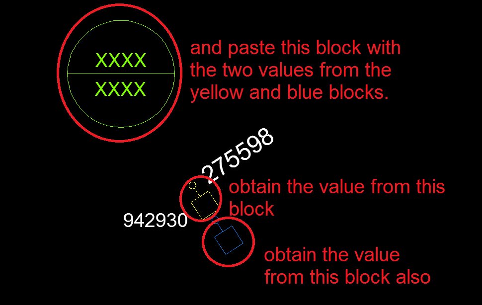

Hey guys and gals,
I need help from one of you Lisp experts that will allow me to....
quickly select from two separate blocks and copy a certain attribute value (from each block) then insert a block with those two values within the inserted block.
One of the attributes needed from one block is named ASSET_NUM and the other required from another block is the same ASSET_NUM
the block inserted is named SLLANTERN_NUM_NEW with the attributes which contains two attributes SNUMBER and CNUMBER.
thats basically it.. its driving me crazy as i have looked everywhere for an easier way and this LISP routine code is the hardest thing in the world to understand...
much appriciated 🙂
Rico

hi john
Yes basically just a pick, pick, boom solution.. And yes select them by eye.
insertion point is basically wherever.
I have an amount of 100's of these to do so adding them manually is a bit painful at times.. Just the use of this will simplify my job quite a lot. If not i'll just keep doing it the way i am now..

Hi, Enrico.
I am working on it for you, but a little confused.  If both of the picked blocks contain attributes named ASSET_NUM, then how do you tell which of them goes to SNUMBER vs. CNUMBER?  Is it by the order of your picks, meaning the first ASSET_NUM goes to SNUMBER and the second goes to CNUMBER?
And in the new block does SNUMBER come before CNUMBER?
Also, is the SLLANTERN_NUM_NEW block already defined in the drawing or at least exists in your search path?
John F. Uhden

Enrico,
A few more things...
1.  Please post a DWG of the SLLANTERN_NUM_NEW block saved back to 2000 format.
2.  Do you want them inserted on/at
     a.  A specific layer?
     b.  A constant rotation angle?
     c.  A constant scale?
3.  Do you want the selected blocks deleted?  If yes, then before or after the insertion?
John F. Uhden

@Anonymous,
Here's my attempted solution.  It's really not tested, so let me know how it doesn't work.
Our thanks to @pbejse for the ATTREQ suggestion.

Hello John,
I appreciate the help 🙂
Just to answer your questions.
a) yes i would like them to be just on layer "Equip_SL_SP_NEW"
b) the rotation set to "90 deg"
c) the standard scale of just 1
And the selected blocks are not required to be deleted.
Here's a drawing that includes the blocks that would require the information/attributes and also the block that will be inserted.
Once again thank yo so much for the help.
I have tried the .lisp routine though it come up with a "stringp nil."
Message 10 of 17
john.uhden
I'll figure out the stringp error and include the layer setting.
If the layer doesn't exist, what color do you want it to be?
Linetype?
Do you mind if I have it ask you for the insertion point before it begins the "insert" command?
Right now I have it asking if you want to delete the selected blocks, with a default of "Yes."
Do you want me to change the default to "No" or just skip the option altogether and not delete?
As to rotation, do you want me to adjust for viewtwist?
You want me to add the prefix "C " to the SNUMBER attribute?
You want me to add the prefix "L " to the CNUMBER attribute?
The 2nd block has an attribute tag of "ASSET_NUM_001."  Is that the standard, or should I do a wildcard check ... "ASSET_NUM*?"
If yes, is that for both the 1st and 2nd, or for only the 2nd?

Hi John,
Linetype?
layer "0"
that is fine
just leave it as i am trying to work out how this function works within the code.
yes please
yes please
yes please
not too sure what you mean here. i can only see the attribute ASSET_NUM on both blocks.
After all this, I trust that you will study each line of code and learn to create these thingies yourself.
Oh i have been reading this code over and over trying to work out how you have come about it.. will take some time but i'll get there 🙂 Just the amount of set variables are something im going to have to read about again.
thank you
