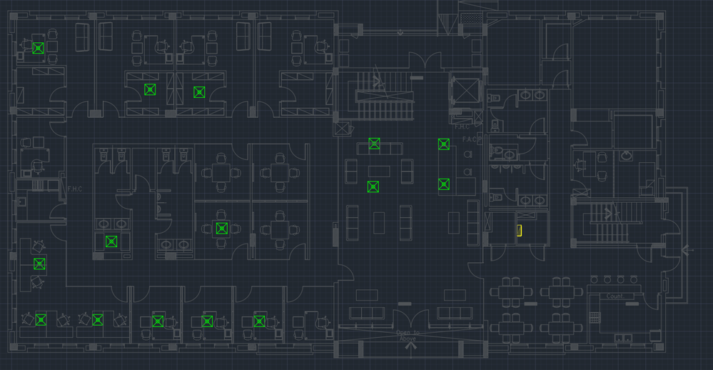

hello
i want help for creating lisp for me please ... the lisp will do these functions
1- as the attached image if i have block with yellow at right and some green blocks 1a.png
2- i want when i launch the lisp to ask me to draw poly line that i want as in image 2
3- after that when i draw this path with polyline and press enter the lisp ask me to choose blocks that i want to connect to this polyline and i will choose one by one or multiple blocks then after choosing the blocks and press enter ... the lisp will offset the main polyline that i draw and connect every polyline with the basepoint of the blocks that i choose sequentially as appear in this image (attached DWG)
can anyone help me please
